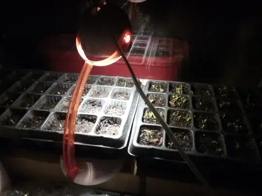

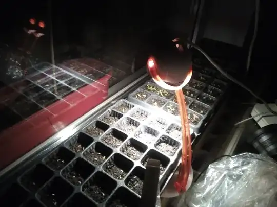

If I keep the regular (so called warm white) night lamp during nights above my Echinacea angustifola and Rudbeckia hirta seedlings (like pictured in the photos), would it be helpful or harmful for seedlings?
The lamp is 3W, and doesn't produce any significant heat.
This setup was only for taking photos, I turned off the lights.

Does nothing, Vivid, for the plants. Plants need dark as well as light. These baby plants need acclimation when you want to transplant them elsewhere. I am unable to see your pots clearly, is this soil soggy with water? Looks like you planted more than one or two seeds in each. This might cause problems when you thin to just one or two plants...which you should do now not later....
If you want a night light get a green light. Nice grow room btw!! Allow those little pots of soil to dry out before watering. Too much water will cause fungus and rot.

As mentioned by stormy, your table lamp does nothing for the plants, but it does illuminate the space at night so you can see your seedlings.
If you want to extend the “daylight” hours - so your plants are exposed to more light to help them grow - you should investigate the use of plant grow lights.
