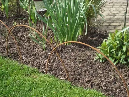

Here are images I've seen online. But to buy something like this already made would be costly. Plus I try to make as much as I can by hand because I take pride in being crafty. So I'm hoping that there is something I can cut and bend to the shape I want and place them in the ground. I want the sides of the hoops to be no more than 12-16" wide, give or take. I like the aspect ratio the most in this first photo below.

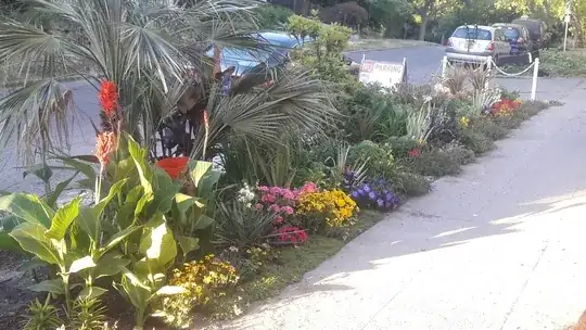

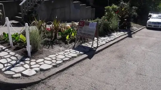

Here is a pic of my sidewalk garden. I am putting taller stanchions along the sides and back (toward the curb) but want to do this smaller "hoop" design in the front and along the two pathways I created that are in the middle. You can't see them because the plants are too tall. But this hoop idea is pretty much my only option because our home is on a hill. You can sort of tell by the photos I took below. Take notice of the vertical stair railing in the bottom photo to get more perspective on the slope of the sidewalk. So placing something like this individually to allow for the elevation to one side would be ideal. I won't do longer garden fence panels because then the vertical portion would look crooked. I see some people do this in gardens that are on hills and I don't like that look at all.

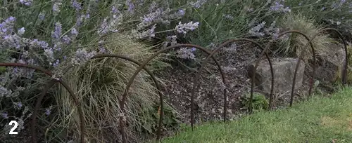

The top picture has the best diameter and placement. The lower picture the rods are too skinny. I love the rust color. That will allow your plants to be the focus. White comes forward. Black recedes. Your collection is beautiful but adding a white little fence will make it look way too cluttered, busy and the only thing people will see, can't be helped, is a glaring little fence.
Just thought I'd offer that up. I can see that top photo's fence being a perfect addition to this bed. Yes, you can see the white at night but to not see the white would make someone much less comfortable getting near your plants.
Here is an idea for material that you could spray paint with rust antiquing that really looks great, uniform and would enhance your bed, protect it but not distract from it. 1/2" would be similar to the upper photo's thickness of metal. It bends down to 3" radius which should be more than sufficient for your fence. Cut lengths that include at least one foot on either end to be shoved into the soil.
