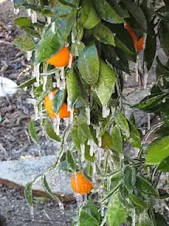

oranges coated in ice
This is a picture from a blog entry that gives you details from the citrus farmer's point of view.
