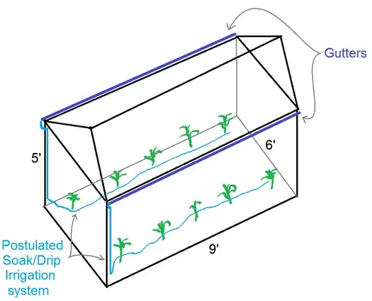

I see a lot of talk about storing rain for later use in a greenhouse... But what about letting the rain flow into the greenhouse instead of storing it?
If a small 6'x9' greenhouse has gutters, would there be more harm than good if the gutters somehow diverted water inside? I'm thinking of a pipe or hose that directs water from the gutters and brings it inside and then uses a soak/drip irrigation hose to administer it to the plants.
Greenhouse gutter diagram

Two things: Most rainwater collection systems have a diverter to allow the first few minutes of rain to NOT go into the collection barrel, or what have you. This first water tends to have a lot of dirt and dust in it. If you created a system like you describe, you may want to rig up some sort of diverter to avoid this water.
The other thing I thought of was the water pressure. Coming from the roof/gutter to a bench or floor may have more pressure than you need. If you do manage to deal with the pressure using soaker hose you may run into the water backing up into the gutter and spilling down the side of your greenhouse.
Rainwater is definitely better than tap water, IMO, but it does lose it's acidity sitting in a barrel, so there's that.
