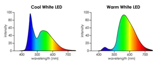

Adding to stormy's answer and some comments I recommend using a daylight and warm light bulb mixture to ensure the plant is getting the full spectrum of light. Using just daylight or just warm light doesn't offer the whole spectrum of light that the plant needs when growing. You can use grow lights that use red/blue LEDs since those are the two colors plants need the most. But full spectrum is better yet. The picture below gives an idea of how a warm light and a day light compare (please note these graphs are for LED, but similar results are found in florescent (T5, etc))
Cool white vs warm white

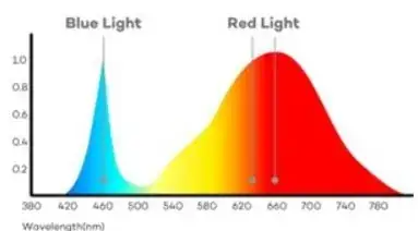

For grow lights like what I got from amazon you get something like this...
Grow light
You can find this grow light (what I got anyway) here. They work pretty good

Picture from this website, nothing from the website aids with answering this question otherwise
