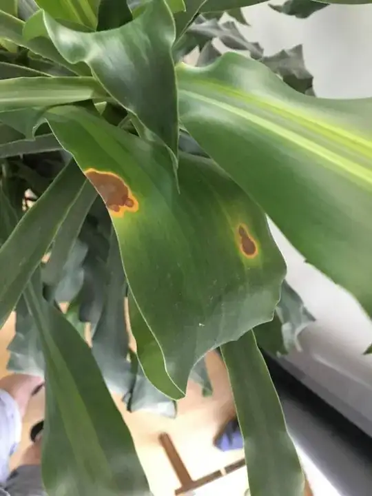

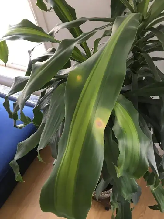

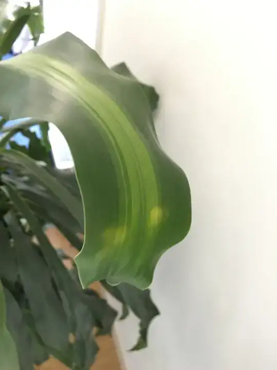

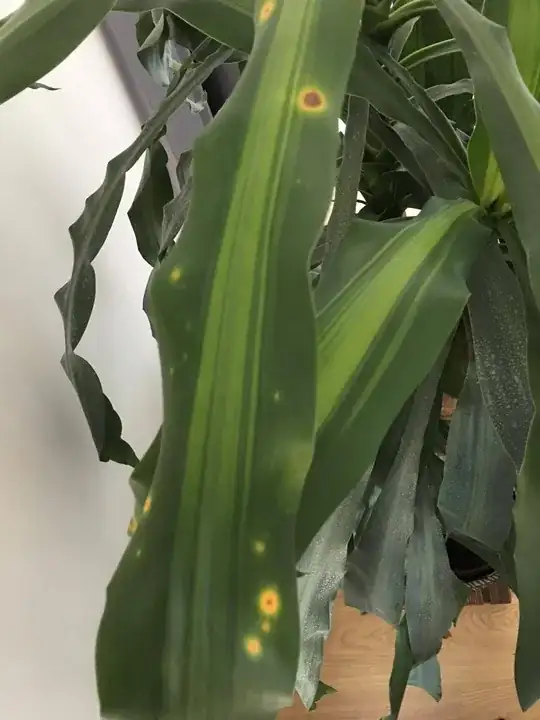

Over the course of the past week I noticed spots developing on some of the new leaves. These start as faint yellow halos and seem to develop a brown core quickly over the course of a few days. The brown part is ~5 mm in diameter, while the halo can reach 2 or 3 cm.
The plant gets watered every 5 to 7 days (I have to admit I usually follow a schedule rather than checking moisture). The pot has no outflow, so there might be some standing watered at the bottom after each watering.
This condition has never been present on this plant before, and even now it has only developed on three or four leaves, all fairly recent.
In the last 3 years I have not given the plant anything other than water. I worry that this condition may be caused by a lack of nutrients.
My questions:
  • What is this condition? (My research points to "Leaf spot disease", apparently due to fungus)
  • Will flushing the plant help it recover?
  • Do I need to cut off and dispose of the affected leaves?
  • Can the fungus spread to healthy parts of the plant if I touch them after touching infected parts?
  • How can I heal the plant and prevent its recurrence?
  • Should I give the plant any supplements?

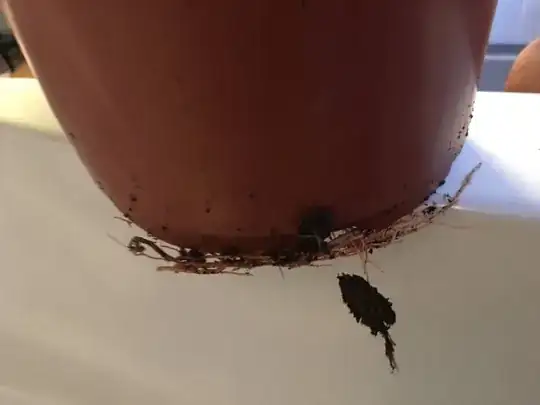

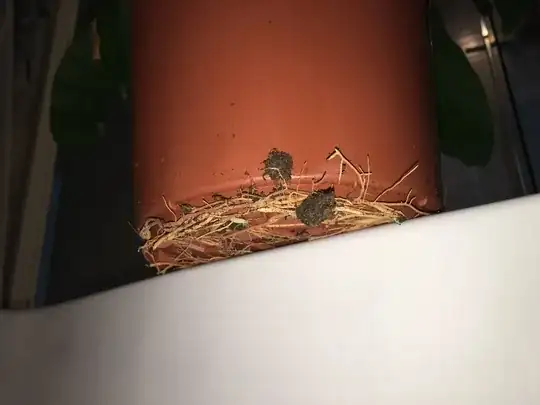

EDIT: I took the plant out of its outer pot and noticed there is a fair amount of roots sticking out of the bottom. Pictures added at the bottom. - Is this plant excessively root-bound? - Is this a potential cause of the disease? - Should I change anything about its current potting situation?

Your plant needs to be transplanted into a larger pot. Absolutely. This plant likes a bit of constriction in its pots but this is indeed time to transplant. Not sure what the diameter of this pot is but you will need a pot at least 4 to 6" larger than this pot, use only potting soil, nothing else, I'd get a heavy clay pot or sand cast concrete for weight. Plant gets top heavy and will need a good base, heavy pot. No gravel or rocks in the pot. Just potting soil. Lightly firmed, completely watered as it is being re potted, unless there are branches in dire need of artificial support or the branch might break, do not stake this plant. Let your plant grow a thick and strong truck to support the top growth of this plant.
It looks to me that this pot was inside another pot, yes? You have to transplant it in a larger pot and from the amount of plant I am seeing you need a pot 6" bigger than this plastic terra cotta colored pot.

Those spots could be a number of things...right now the least of this plant's worries. Normal spots. A plant that has had no fertilizer will most certainly not be able to fight disease or insects. And will have spots. What kind of lighting, what orientation of window? Drafts? I'd try to keep this plant in its original location until it gets used to new soil, fertilizer...
