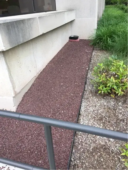

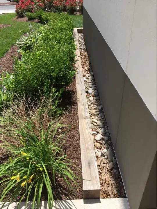

Where I live, I've noticed many buildings have a stone/gravel barrier between the building foundation and the lawn or flower bed. Why is this? Does it prevent insect or pest infiltration of the structure?
barrier1
barrier2

Perhaps I missed something in the other answers. The one and only reason is because of SPLASHING. Rain over the gutter, a hard sideways rain will splash mud/soil onto the siding. Not good for siding as the mud tends to hold moisture too long and can cause rot as well as a dirty 'skirt' on your siding.
The gravel, drain rock, cobble or even the lava rock as pictured in the first picture however needs to be below the siding at least 4" otherwise the rock becomes a moisture problem. That first picture with the lava rock and the trap? That lava rock is touching the siding. The siding appears to be concrete. Concrete foundations need to be coated with asphalt for protection. Concrete is very much harmed by moisture. The picture with the 4X6 holding in cobble? If that rock is as close as I think it is to the siding, that will rot the siding if it is not at least 4" below the siding.
