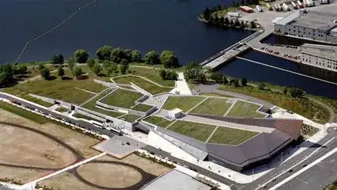

Roof of the War Museum, Ottawa : still looks good after many years War Museum Ottawa

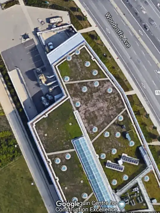

Algonquin College: as built Algonquin College
and as it looks now after a hot summer with, apparently, no maintenance Algonquin College aerial view

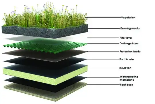

Here is a visual of a typical installation. A lot of preparation required green roof schematic
