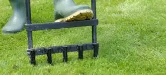

One of my dogs (female) loves to pee on mulch. My other dog (male) loves to pee on objects (not surfaces). If she were peeing where I didn't want her to and I wished her to pee somewhere else I would make the other spot more attractive by adding mulch. If I wanted to be sure that the new pee spot did not smell like pee I would use aromatic mulch such as cedar bark. If I wanted him to pee somewhere else I'd position an object he liked to pee on in the target zone. Of course coupling the target zone hits with rewards in the usual dog training manner (off topic here).
Is there a something in particular that your dog loves to pee on? Maybe use some of that in your target zone. And during the transition period consider adding a small fence around the no-go zone. (Based on the photo in your profile it would not need to be a very big fence would it?)
Failing that... agree that the local problem is drainage. Assuming 1) that you want to keep grass in the current pee zone and 2) you can't train the dogs away from there... you can look into improving drainage in the area.
If you just have a small zone to aerate you can use a simple turf aerator like this one:
turf aerator
