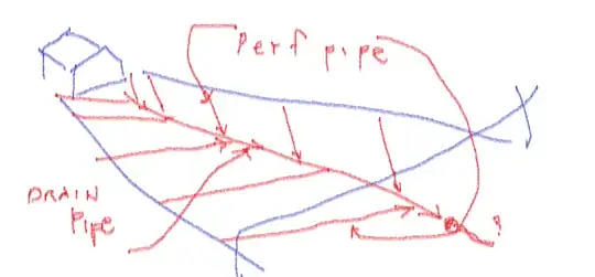

I am trying to draw using a mouse, okay? This is the best I could do right now. Does it make sense? Downhill is to the right on a simple rectangular lot. I assumed your home is uphill. If it is downhill, that gets far more important and one does not ever direct water towards a home, no tying into the foundation drain that kind of thing. At least these are big no no's to try to not do? a sketch of herringbone drainage
