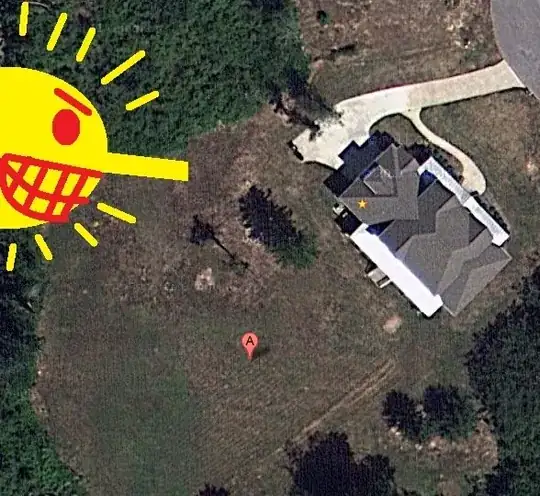

The place to plant the tree is key too. Here is an overhead view of my house: enter image description here
Do you see what the evil sun is doing every afternoon from 2-5? He wants to bake me.
I understand this task will require a bit of patience so anything that would provide shade in the next 5 to ten years would be fine.

So, that's the main trade-off. Looking at your picture, it looks like you already have a tree well on its way to shading that entire end of the house. What you could consider doing is plant a few quick-growing trees that will get you the shade sooner than later, and then remove those trees another 20 years down the road when your other tree has matured.

The one shade tree you have there looks like a red oak or similar. These should grow fairly quickly if properly encouraged. Every year put tree food spikes around the drip line, and water regularly if not getting enough rain. Also, an interim solution would be the 3 pane window and attic insulation. Also, a arizona ash will grow very quickly and can be removed once the red oak matures.

NMOsZ "vicious sun" 2-5pm photo indicates that BVFcU photo is nearer to midday.
BVFcU shows downspout (gutter drop, leaders, whatever) extenders. The driveway itself looks well-graded. The grade near the house looks too flat, IMO. OTOH, your soil looks like coarser loam or "dirty" sand, and camera lenses distort.
The state of the mowed vegetation looks more like summer or fall than spring.
Two A/C compressors on side of garage? They would like shade, too.
Water drains down fast in deep sandy soil. OTOH, the water table stays shallow near year-round rivers. County ag (cooperative extension) might have soil maps. The nearby woods suggest nothing extraordinary.
Your back (SE side?) has tilled ridges. Photos don't tell much, but the woods looks consistently immature height. Was the area clearcut 15-20 years ago?
