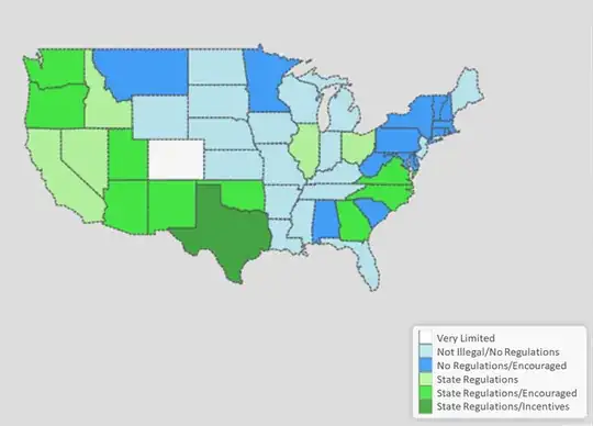

Here's an up-to-date resource concerning the legality of rain collecting across the U.S. states since this question is often asked. Pacific Northwest National Laboratory, was contracted by the United States Department of Energy to produce this publication: June 2015, “Rainwater Harvesting State Regulations and Technical Resources”: ![United States Rainwater Harvesting Map
The U.S. Department of Energy contracted for the compilation of state and local laws and regulations concerning rainwater harvesting. The above map is an excerpt displaying States based on applicable regulations, lack of regulations, and/or governmental encouragement/incentives for rainwater harvesting. Note the map displays only Colorado State as being “Very Limited.”
Within the Continental U.S., the majority of States actually allow, if not support, rainwater harvesting, not ban it’s use, but very local health/law codes should always be checked. Colorado is the only state with extensive law restrictions applying to rainwater harvesting, and even then, the action is only limited and is due to water scarcity within the region and a sensitive environmental balance that is trying to be maintained for many reasons.
