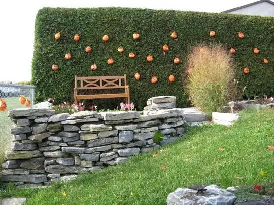

Here is a "before" picture of the slope I had to deal with
