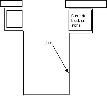

The question was asked about what shape of tank is better when using pond liner. Circular is a little better but no matter what you do you will get folds and creases in the liner. Water goes where it wants to so to prevent capillary action allowing water to go up and out of your pond you can construct it using this method below:
By folding the liner on top of a block or stone you accomplish two things:
  • it's now safer to stand on the edge as your weight is distributed over the area of the block
  • any water moving via capillary action up the folds and creases will remain in the tank
After you have the liner in place and the perimeter set up let things settle for a few days. You can only cut the liner once and it is difficult to patch.

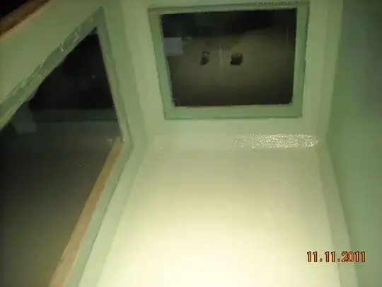

I built a 112 gallon aquarium with tile board and drylok. Still going strong at 4 months! I am a Master Plumber and I have seen what others have seen when remodeling showers. Water marks, mold and such. I can say that there is NO way this will leak, NO WAY. Let me know if you want details.
enter image description here Source plumberman from the forum attached.

Even with the link attached above where some guy has claimed he has done it this is something I think will be a YMMV kind of thing. That guy was a plumber and knew what he was doing. You could try it, but it make take a few tries to get it.
