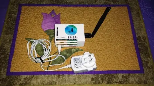

I have used two wi-fi controllers for our irrigation from http://www.hottimesoftware.com/wifi-time-control.htm and are happy with the results. Uses the Raspberry Pi to operate the solenoids and can be set to auto or manual functions. I can now control from anywhere in the world with my smart phone. enter image description here
