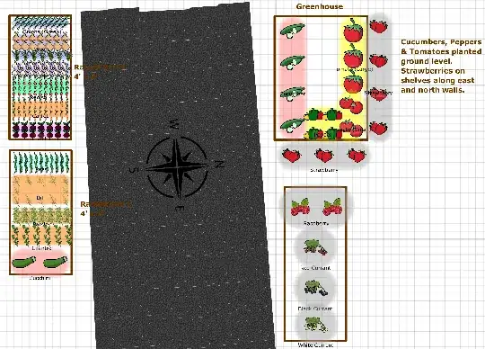

After trying to figure out how many of each, spacing, etc. I stumbled upon The Old Farmers Almanac Garden Planner which made my laying out a breeze. Using their software, this is what I came up with.
Garden Layout

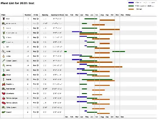

Plants List
Based on these results I have several questions:
1. Has anyone used this and how accurate it is spacing wise? For example - Can I realistically only fit 5 tomato plants along 1 of the walls of an 8 foot long greenhouse? Is there actually enough space to fit 33 carrots plants as the software suggests?
2. What kind of yield can I expect from 7 plants of chives, 2 plants of zucchinis, 4 pepper plants - is it even worth the trouble for such a small number of plants?
3. The software provides a plant list with indoor/outdoor sowing times and plant out times. Could I just sow everything indoors at the same time and plant them all out at the same time (assuming there is no risk of frost)? Or sow everything indoors at the same time and plant them out according to the suggested schedule?

Wow, Where to start? I guess with a critique of the plan...
  1. As Giacomo noted, vegetables in the same family can share diseases. For example, peppers, eggplants, potatoes, and tomatoes should never be planted in succession on the same plot of ground. I always plant peppers, tomatoes, and eggplants in the same bed, then "move" that bed yearly. Yes, I'm taking a risk with this (if one variety picked up a nasty disease, I could loose ALL of my Solanacae). I do this because it's easier to rotate the crops (see below). Other related vegetables are the brassicas (cabbage, brussel sprouts, cauliflower) and cucurbits (cucumbers, melons, pumpkins).
  2. To reduce possible disease issues, you need to rotate all of your crops each year (I use a three-year cycle). This means that you need a third raised bed.
  3. To get the third bed, it's not necessary to plant the currents and raspberries in a raised bed - plant them in the ground. Your soil should be just fine for them.
  4. Speaking of raspberries, plant them where you can have a "patch". They're often planted in a row, with cross-shaped supports used to hold the canes upright.
  5. You're not taking advantage of crop succession. For example, radishes will bolt in late spring, so you can plant them in the same bed that you plant your tomatoes and peppers. Peas will bolt later, and can be planted with zucchini or cucumbers (depends to some extent on pea variety). This also helps spread out your crops a bit. Dill and cilantro also will set seed rather early and then die (especially cilantro). If you use lots of those crops, then you should seed them periodically through late spring.
  6. To answer your chives question - one plant should be more than sufficient, unless you use massive amounts in your cooking.
  7. Garlic is always planted in the fall and harvested in late summer. I never plant it in the same bed as onions (same family).
  8. I plant three tomatoes in a ten foot bed (they're on three-foot centers, each with a two-foot diameter cage). Five in your greenhouse is a recipe for blights, insect pests, and other problems. You need the space between them for proper airflow, which is another reason you don't want to use the greenhouse for them.
  9. Use the greenhouse for starting plants only if you're going to be there to monitor the plants.
  10. Your watering setup may not be needed. I rely on rain for my vegetables, with maybe one or two waterings each season. Depends on your region's annual rainfall totals, though. Tomatoes and peppers can take an awful lot of dryness.
  11. Currants can carry white pine blister rust (see here for PA-specific info), so make sure you get resistant varieties of those plants.
  12. I'd mulch everything, every year. This will prevent water loss and severely restrict the growth of weeds. You could use wood chips/shredded bark on the currants and berries, because those never move. I use cocoa bean hulls for my other vegetables, because they break down yearly and add to soil tilth. Not sure if they're available in your area, though.
