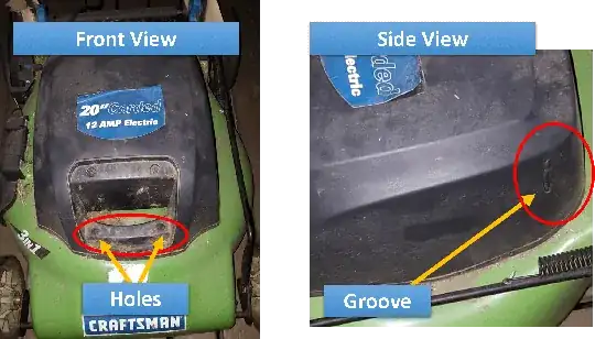

The lawn mower suddenly stopped working during grass cutting
Lawn mower details
I have an old model of craftsman lawn mower (2013 model?). It says 20" corded 12 Amp electric on the top. I am trying to open its motor cover to find the problem. But I can't find any way to open the cover. There are 2 grooves on either side, and 2 holes at the front (see the images below). I have tried to use different screwdrivers in them to unscrew if there are any screws in there (can't see any). But nothing has worked so far. Please help me opening the motor cover. I can't even find the manual online.
How can I open the motor cover? Thank you for your time and help.

That model or a similar appearing model has the battery cover/cowl snap/clip on, so maybe try wriggle it a bit, as any debris shouldn't impede removal too much: the grooves may be spring detents, and the holes could have screws down in them, or simply plastic clips. then to put it back on, clip it back into place & check that its held on ok.
