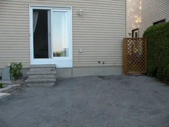

We live in the same province so it may be helpful to look at what house builders have been doing for the past thirty years. Common practice was to take a pre-cast concrete step and attach it to the foundation with two steel rods as seen in this picture. This kind of installation lasts the life of the house.
precast concrete steps
This method has the advantage that it's not moving: ever. The soil around a foundation can continue to subside for many years. Clay soils will rise and fall with the seasonal changes in moisture and any areas of poor drainage near the foundation will make this more noticeable.

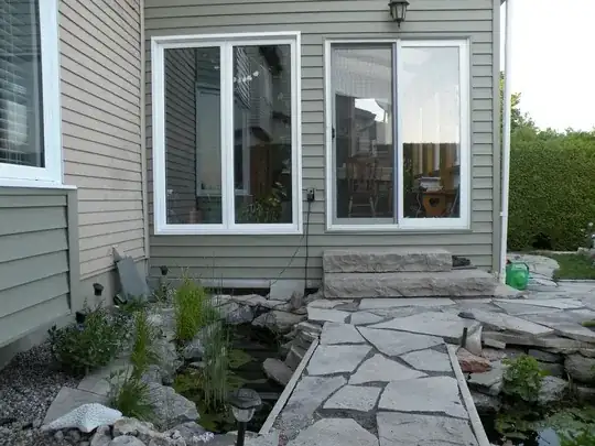

My preference was for solid stone steps that I installed here
Solid stone steps
I ignored a few common practices putting these in.
  • I did not prepare a new base of compacted crushed stone,instead I relied on the previously undisturbed base
  • I only used a two wheel dolly and some friends to move the 400 and 600 pound pieces
I had to shim one step by one eighth of an inch after the last winter. Took five minutes.
I think solid stone steps are worth the expense and effort.
