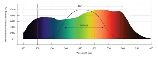

Lumens is a measurement humans use to perceive how bright a light it, it essentially has no meaning to plants, as some of the posters before me have said already, strong lumen even 10,000 in the wrong spectrum or colour will not benefit your plants.
What you want, is sufficient amount of PAR (photosynthetic active radiation) PAR light is the wavelengths of light within the visible range of 400 to 700 nanometers (nm) which drive photosynthesis, also with a good mix of IR (infrared) and a small dose of UVA (which actually helps to activate more oils/flavor compounds in plants like Basil)

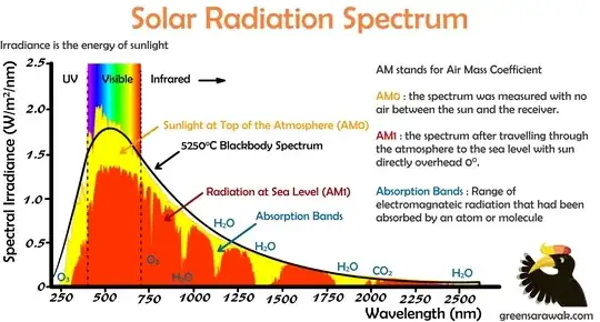

spectrum
the sun's spectrum
As you can see, the sun's spectrum is way more far ranging than an average LED light at home and as we know Tomato plants originate from South America, where temperature are fairly high and they also love the sun. Here are some resources I think would help you in terms of growing tomato plants.
