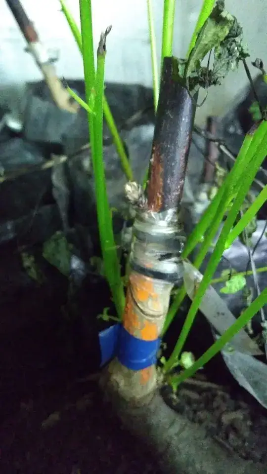

Quite a few of the graft buds (about a third) have started growing and then died off/dried out. Is this normal or does it indicate something that we're doing wrong? Pictures show an example of this (blue tape), as well as a successful graft after removal of cable ties, tape etc (yellow tape at bottom of photo below graft). Note I removed the cable tie from that successful one a bit late, so you can see the indentation at the grafting join.
unsuccessful graft example
