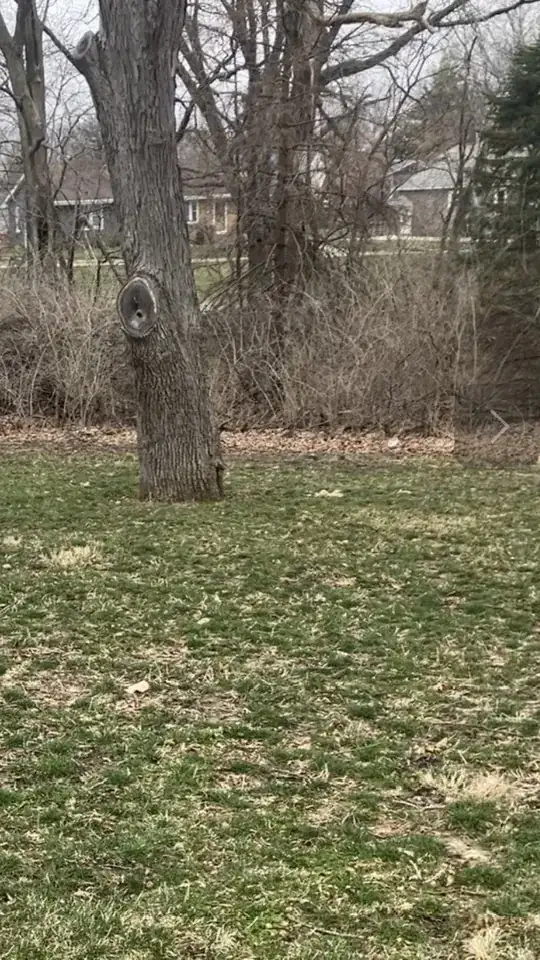

I have recently purchased a home in Illinois. The yard was in terrible condition before. There were big bushes growing all around the yard (as shown in picture two). Now there are only patches of grass growing.

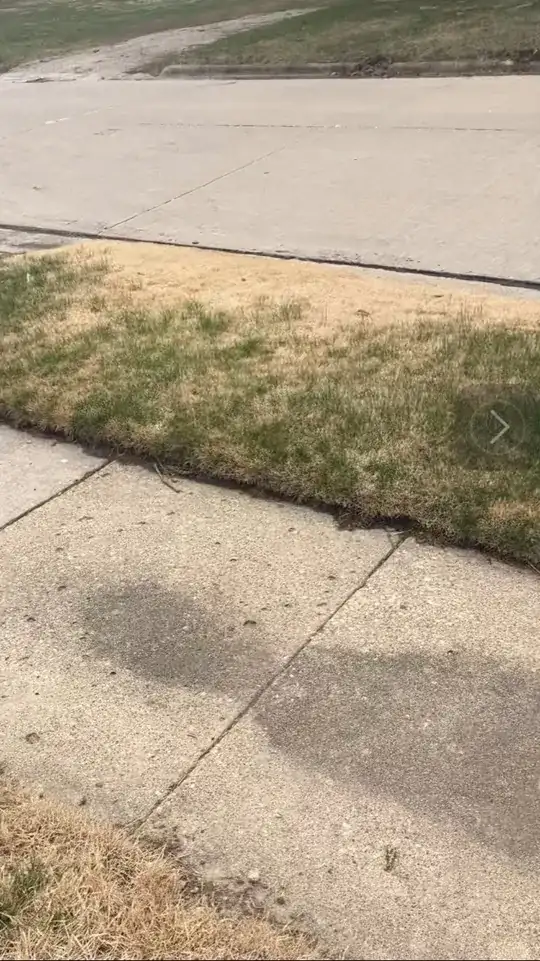

The yellow stuff by the street looks like chemical damage, probably road salt like Jurp mentioned, not a surprise Bermuda-grass infestation like I originally suspected.
The backyard looks like a typical (winter) Midwestern lawn to me. To make it lusher and greener takes a lot of chemicals (pesticide, herbicide, and fertilizer) and regular watering. You could aerate those dead patches and overseed them to fill them in. An even more expensive quick fix would be to re-sod: basically, import rolls of healthy grass and plant them on top of the existing yard. But then you’d still have to take care of it.
It’s also worth questioning whether lush green grass is worth it to you. Your neighbors don’t seem to do much to “juice” their lawns either, so we can assume it’s not a requirement in your neighborhood to have picture-perfect grass. How it is now will look fine enough during the outdoor season.

Based on your photos, I can speculate that photo 1 shows a poor use of road salt by your municipality and/or the homeowner—it looks like a snowplow accidentally dumped too much by the driveway and then the homeowner made things worse by over-salting the sidewalk.

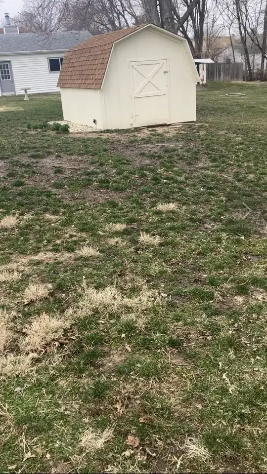

Photo 3 (and a little bit in photo 2) shows a number of light tan tufts of apparently dead grass. My lawn in Wisconsin has these too; this is not a dead lawn grass but a dormant weedy grass. I've never been able to identify it, but it'll grow about 6-8" tall if not mowed and seems to spread a bit. The good news is that it'll turn green later in spring.
The area by the shed may be the result of compaction from vehicles when building the shed and/or may be the end result of covering gravel with a few inches of soil and then seeding. In either case, drainage appears to be the issue. The easiest way to check is to simply stick a shovel in the soil and see what you get when you turn it over; if you can turn it over, that is.

If the area by the shed is indeed as compacted as I think, then you'll probably need to till it to break up the compaction, then smooth it and reseed it. If it's gravel, then you'll need someone with a skidsteer (try to keep it on the gravel area, not on the rest of your lawn). They'll have to skim off the gravel and replace it with topsoil, after which you'll need to smooth it and reseed.

  1. The first picture may actually show an area that needs dethatching (thatch being defined as dead grass crowns). The solution here is to rent a dethatcher for that area.
  2. The previous owner may have one or two dogs that hung out by the shed. This would at least partially explain the terrible lawn there. If there is no compaction or gravel, then the solution would be to grub out some of the dead areas and reseed in May.

The 'hellstrip' section by the road could be a variety of grass that turns yellow when dormant. I've known of entire yards that do this every year. It could be salt damage as well. If you get a lot of snow and plows pile it up there, it's always going to be a struggle. I'm actually considering an alternate ground cover for that issue at my home.
The second image seems like the least of your worries. Overseeding and fertilization should improve things. When buying seed, look closely at the label for not only the mix but also the detected amount of 'weed seeds' and 'noxious weed seeds'. The definitions of those terms vary from state to state. Also pay attention to the date of testing. The percentage of expected germination decreases with age.
The issues in the third picture could be a number of things. It kind of looks like there are tree roots at the surface but I'm not sure. You mention a large tree, but I don't see any in the images that I would call especially large. But if there is a very large tree, it's roots will pull nutrients from a wide area. Mainly under the drip line but perhaps more.
