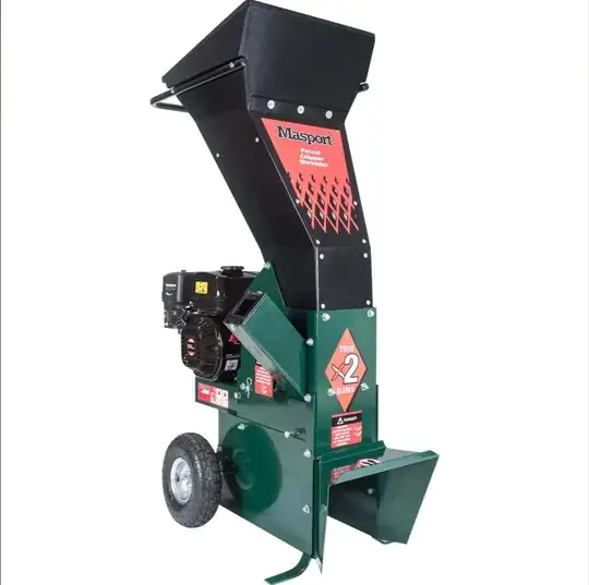

We used to have one a decade ago. Generally the thicker the branch it can take, the coarser the material output. I would suggest that you go for an inch or 25mm, certainly no wider than 40mm input tube.
Ours was 40mm, and the output was pretty good for mulching. The odd fine branch would come through. Also, the odd fine branch would jam it up.
We stopped using it after a while because it was totally unsatisfying to use. I would feed in what I felt was an enormous amount of branches and leaves. It would take a while, to feed in slowly (to avoid jamming). And after an hour or so, I would get half a barrow load out, which was not enough for anything. Admittedly I had a 10-acre section at that time. Basically, I did not feel it was value for money in terms of the time and petrol and capital layout.
Newer models may be a lot better.
The tube I am referring to is the one on the side, where you feed in thicker branches without leaves. This was the brand we had, but it was easily 10-15 years older
