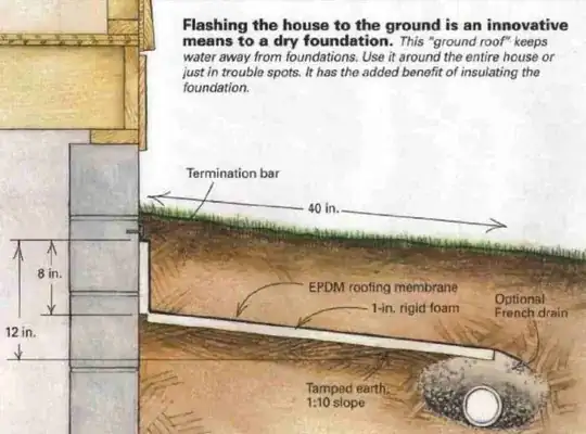

  1. For the sloped and flat garden beds, I want to regrade the area immediately adjacent to the walls. Can I simply add some more soil to the top and grade it away from the wall? It would be a good amount below the foundation but it would still touch the siding. Also, moving around the existing soil in some parts might be more difficult due to the existing plants in the way. I was also thinking of digging a few inches below the grade first and line some roofing membrane against the EIFS wall as an underground flashing to also help keep water away and limit soil contact, something like this:
    Would it be ok if I didn't lay it down as deep or as wide as the diagram shows?
