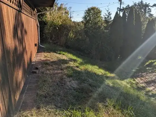

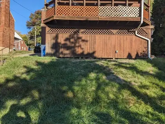

I will get some pictures up later tonight, but my back yard has about a 30-40 degree slope from the driveway down to the relatively flat part of the backyard (past which is a stone wall before a drainage ditch before my back neighbor's yard. Recently, I noticed a bare pipe on the slope, probably uncovered by slow erosion, which I think goes to a drain. Obviously, I want to cover it back up, but I'm inexperienced with landscaping, and it feels like dumping a bunch of soil over the area is just going to smother the grass and then erode away. Keeping in mind that I'm probably only going to be able to put an hour or two into working on it a few days a week (combination of work, toddler, and general other drains on time), what are some good solutions to fixing that sort of a thing up? I honestly don't know much about what's underneath the grass, other than that there's at least one point where I think a different drain exits (I remember noticing more water flow coming out of it one rainy season), a rabbit den (filled with gravel and then dirt, and then let the grass grow over it) and an ant hill (I know... weird thing to mention, but we had a big one, and the area where they built it up sticks out a bit from the landscape and never quite recovered grass-wise). At the top of the hill is a section of patchy grass I've asked about before. The actual lawn is a variety of grass and other plants that aren't noxious enough to treat as weeds.

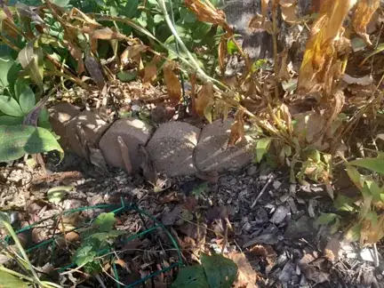

By "terraces", I mean plant-specific mini-walls. For example, if you were to get some large cobbles (say, 8" x 12") and partially sink the into the hill just a few feet below each shrub. This would allow you to give the shrub a flat surface and also prevent the soilmulch from floating downhill. Here's a photo of what I mean - in this case, with old and ugly pavers:
This mini-wall is only four feet wide; the hill continues on both sides of it. Note that the pavers interlock and are staked into place every few feet.

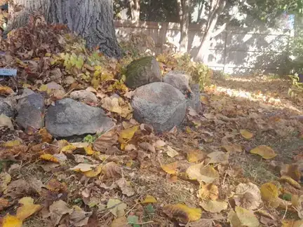

Here's an example of a mini-wall with cobbles (in this case, acting as a mini-retaining wall):
In this case, no staking is needed if the cobbles are big enough and buried deeo enough. Note that there are two levels of cobbles used in this wall.
