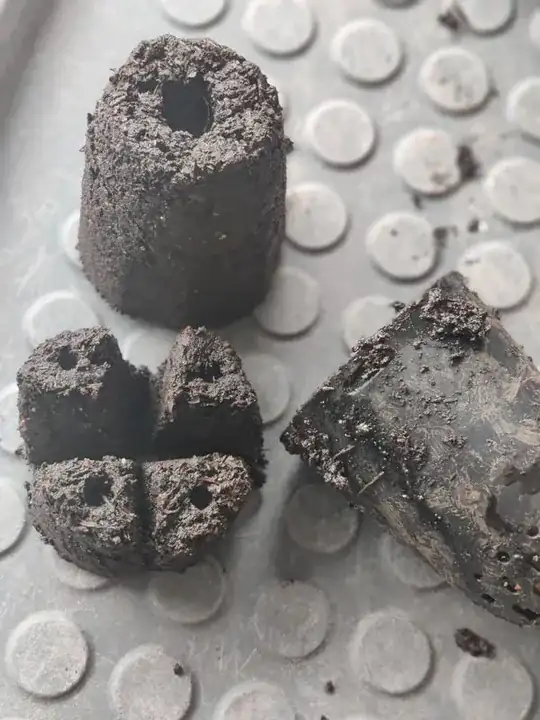

Larger soil blocks also hold together better than small ones. I use a Fiskar soil blocker that makes two sizes of soil block:
A picture of two soil blocks, a larger two inch cylinder with a dimple on top and four smaller blocks that each make up 1/4 of a circle similar in size to the large block
The large 2 inch cylindrical blocks are easy to work with. I will have maybe 1 failure in 25 blocks. The smaller 3/4 inch blocks have about 1 failure in 4 blocks.
