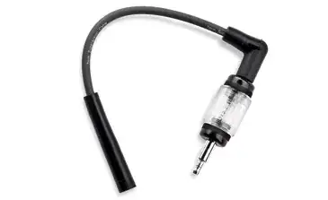

Use a Spark tester (which can be found at any automotive supply store), to test the spark.
Spark Tester
To use it:
  1. Remove the boot from the spark plug on the trimmer.
  2. Plug the end of the tester with the metal probe into the boot.
  3. Connect the other end of the tester to the spark plug.
  4. Give the trimmer a couple pulls, while watching the testers spark chamber.
