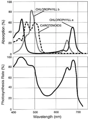

    As Wikipedia shows, plants need mostly light from the visible spectrum:
    Active radiation,

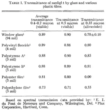

    at which range both glass and most plastics transmit most light. A quick scholar.google search gave me The Radiative Effectiveness of Plastic Films for Greenhouses, with the following info.
    The mil used here was strange to me, which I converted using the first converter Google gave me. It seems that there is hardly any difference between glass and plastic here, although there are special glasses designed to transmit >99% of the sunlight, as described in Transmittance of optical glass, which are out of reach for most people due to their cost.
