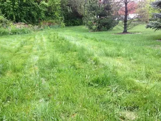

I have this mower. It worked great last year, but this year it's left my lawn looking like the photos in this album. Believe it or not, I mowed that grass yesterday (not even 24 hours ago).
It is definitely cutting, and cutting a lot (most of the grass is the right height, it's just those long shoots that are persisting). I had the blade set to about 2.5", the notch shorter than what I did last year (an attempt to rectify the problem after the first unsuccessful cutting). I typically only cut when the grass is dry, though it's been raining 3-5 times a week, so I'm usually cutting the 24-48 hours after the last time it rained, but the grass has definitely been dry when I've cut it.
Is this normal for this type of mower? I didn't see this last year at all. Are these just weeds I need to manually pull? Is it the frequency of the rain and the fact that I can't get a day or two of non-rain before I cut it?
Why might this be happening and how can I fix it?

If grass is too long when you take a reel mower to it, it just folds over. This is made even worse when it is thick. After making sure the blades are sharp, you will probably just need to take multiple passes at it.
We own two reel mowers and the way we know we need to sharpen one is when the same grass responds like that on one mower and normally on another. But I wouldn't let the grass get that high. (Yes, I know that's a frustrating challenge when it keeps raining and the grass keeps growing.) The key to success with reel mowing is to do it often. I find that easy enough to do because the mower is light weight and easy to use, so I can do one bit of lawn that's getting long without full on Mowing The Lawn as some kind of production - I just mow the part that's getting long. (We have an acre and a half, but only about half it is lawn.)
If it won't stop raining and the grass won't stop growing and when you get to it, it's like that, well you just keep going over it. Go in opposing directions, that may help a little. When it stands back up, go take another pass at it. Don't worry about what's a weed and what's grass. It all needs to get cut. For more tips, see https://gardening.stackexchange.com/a/5014/754
Update: I was super frustrated with my reel mower yesterday because it was doing that same thing you asked about. I was going over and over the same ground and it would produce clippings, but the lawn still looked unmowed. I sharpened it (which took about an hour) but the result was the same. But while interacting with the reel to sharpen it I came to realize that the "cutting bar" - the straight thing the reel blades need to contact with to slice the grass like scissors - needed to be raised at one end. The blades were not contacting it on the entire left side of the mower. The grass was not getting cut because the blades were not touching the bar. I adjusted the bar and presto! When I mow a piece of lawn, it stays mowed. Adjusting the bar is much quicker than sharpening so check for that first.
To check, put the mower on its back and spin the reel (carefully) with your hand. If it moves really easily and then a bit stiff, really easy and then stiff, look closely at the bar. Are the blades touching along all the length of the bar as they turn? If not, find your instructions and adjust it.

You should not set the blade lower when it gets this long, set it higher and just try not to let it get to bad until the rain stops. The grass is thicker the lower you go so it binds up even quicker. At this point you are probably going to have to go over it twice in a row. I would hit that once at 4.5 and then again at 4. Reduce that by a quarter to half inch each week until you are at the height you want. Just try to stay on top of it now because if it gets much more carried away then you will have an easier time weed wacking your whole lawn in oppose to using that reel mower. You may want to consider hiring a company to come in once just to bring it to a more managable height. Aside from the patch work, Nice lawn.

I agree with the previous poster - you just let the grass get too long for the reel mower between cuttings. When I had a reel mower and that happened, I just used a gas mower to get it cleaned up, and then made sure to cut more frequently with the reel mower to maintain it. Could you borrow a gas mower from a neighbor for a quick cleanup?
