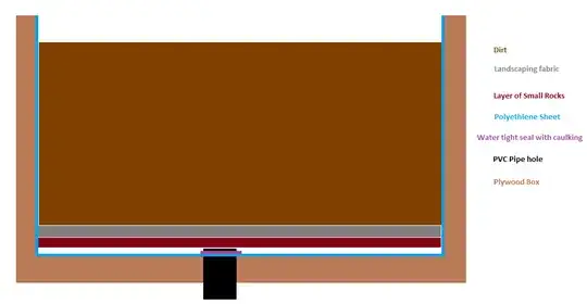

For what it is worth, this is what I ended up doing. enter image description here
If I had to do it again I think I would just do plastic and dirt. The heat of the greenhouse pretty much vaporizes the water in the soil, even on cool days. This pretty much eliminates the threat of root rot. I'm thinking it must be the dry climate where I live. If I built my boxes out of spruce lumber instead of plywood I wouldn't even bother with the plastic.
All in all though they turned out great!

Yes, you absolutely want to have drainage.
Roots need moisture but they need oxygen too and poor drainage is going to likely result in roots that rot and plants that die.
Not sure exactly how your beds are made but you could drill some holes in the bottom and then put some PVC drain ports in the bottom to allow for drainage while protecting the wood. (I'm assuming you've got box-type beds with a solid bottom.)

And DO NOT Use rocks, gravel at the 'bottom' in hopes to improve drainage. This actually makes drainage worse as you've created a 'perched water table' allowing water to move out of the soil ONLY after the soil is completely saturated. It would be good to put pots on wire shelves or use tiles so that they are off the ground, solid surfaces to increase drainage.
