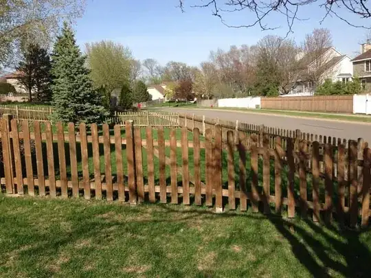

I keep damaging the bottom of my fence with my gas weed trimmer. What is the best way to prevent damage to my fence while using a gas trimmer?

Agree with itsmatt's final solution, but there is another option. Because the fence is too close to the grass, you could excavate a narrow trench beneath, part fill with bedding mortar mix (about 1-2 inches deep, made with 4 parts sharp sand, 2 parts soft sand and l part cement) and then lay pavers in a row,or maybe 2 rows, so that the fence is sitting on those rather than the lawn. Once the bedding mortar has set (1-2 days, depending on temperature) then you'd need to point between them with mortar (3 parts soft sand, 1 part cement), brush dry into the gaps, then water gently over the top, so that you don't wash it out, and leave to set overnight. The mix beneath the pavers and the mortar mix will prevent grass coming up in between the pavers, so it's important that you do this.
Trimming along a wooden (or chain link!) fence is tough and tears up the wood undoubtedly. You can certainly try to do it more slowly and angle the string down toward the ground. That might help but there are a lot of variables here - the ground height, the movement of your arms, the amount of grass and where it is located, etc. - and that's only going to work so well. Plus, it takes a while.
I've seen folks slide old shingles, cardboard, carpet, etc. under the fence to essentially create a weed block. That will work but cardboard breaks down and none of these are all that appealing. You've got that nice fence there so you don't want to go junk it up with some junk laid under it. That's just my opinion.
You could cut a little off the bottom as ekaj suggested in the comment above. This might work well. It's a pain to cut pickets near the ground that are installed. A reciprocating saw (Sawzall is what they are called typically) would make quick work of this. You could cut them so there is 1.5 inches or so of clearance on the bottoms and probably keep the wood from being chewed up by the string trimmer in the future. That's likely one of the easier "one time" solutions to the problem.
Another possibility (though I try to avoid its use on our farm) is some sort of non-selected spray such as Round-up. That will definitely kill the grass and could be applied periodically. A more eco-friendly possibility might be vinegar (20% is available and is quite effective but requires some special handling (gloves, goggles) due to its caustic nature). Vinegar is moderately effective at killing weeds and is cheap (at least the 5% stuff is). These solutions - Round-up or vinegar - will result in a brown area along the fence line which might be undesirable.
You could decide to run a strip of mulch along the fence line. Put down some pro-grade weed fabric and and put several inches of mulch atop that to smother the weeds. Some of that push-in edging would give you a clean line to separate out the mulch from the grass. You could skip the edging but you'd probably end up with a fair amount of grass clippings in the mulch or shooting mulch all over the yard with the trimmer. They make that edging in plastic and in metal too. That's an idea. The problem with this solution is that (I'm assuming) if you share the fence with a neighbor, you've both got to be on-board with the solution or the weeds and grass are going to crop up on the other side anyway.
Personally, I'd opt to cut 1.5 inches off the bottom of the fence and be done with it. It's a one-time cost for the Sawzall, a couple hours of time to mark and cut the boards and then you are done.
