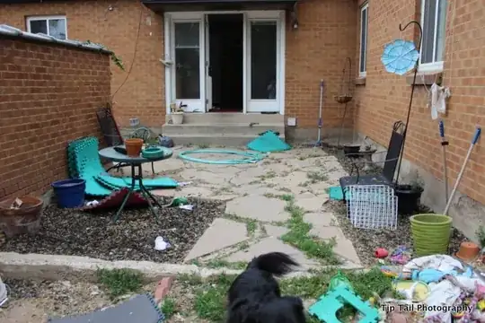

My husband and I are buying a portion of our neighbor's property. Currently, our back yard has this ugly brick wall right by the back, which we are going to tear out. I also want to pull up all the stones in the patio and lay them back down, because they are warped and crooked from years of settling.
Here's a picture.
http://tiptail.com/wp-content/uploads/2013/06/IMG_4750.jpg
The problem is there's a concrete border around the stones. I'm assuming that we're going to have to hire a landscaping company to tear down the brick wall, and the concrete border that goes with it. I don't know, however, if that concrete edging is part of the house foundation. I don't know how to tell.
Should we have the concrete border torn out? If so, what should I use for a border? I have never put in a stone patio or deck, so it'll be a first project for me. I want to add some area to the stone patio, too.
If we don't tear out the concrete border, what can I do to make it look better? Our yard is a complete mess because everything is torn up while we buy the property, build fencing, etc.
Oh, and I'm in Utah, where it gets quite cold in the winter, and very hot in the summer.
Thanks!
Cynthia

Edit: Now I have seen a picture this looks like more of a rebuild than a rip-and-replace. Here is what I would do:
  • remove the brick wall. A sledgehammer and determination should do the job. Leave the concrete base but cut it down to an appropriate size using a a concrete saw with a diamond tipped blade. (This will probably require some excavation to get room to work)
  • Now is the time to consider running any electrical lines if you want power for water features or other outdoor electrical appliances. Check with qualified contractors for the regulations regarding underground electrical.
  • This is also the time to ask if you need shade in the summer. An arbor or similar structure can provide shade and shelter from winds.
  • You have a natural stone patio. Just lift the stone, verify you have a good base of gravel, add more gravel as required. Rent a compactor and run it over the base. Add some stone dust (~ 1/2 inch (1.5 cm)). Relay the stone. You will have to buy some more and this will be a challenge to get a matching type. Take a sample with you to possible suppliers.
@Itsmatt is right to mention safety equipment. When using a concrete saw I use hearing protection, a helmet with a mesh to protect from flying chips and a dust mask. Hot work but the right thing to do.
Edit: Cynthia asks if she could build over the concrete foundation of the wall. Yes, it is certainly possible if you can cut the wall/foundation at least three or four inches (~9 cm) below the level of the new patio. You need room to lay some stone dust to level the flagstones. As with every project caution is advised as until you get digging you just don't know what you will find. The brick wall will have a foundation and it maybe reinforced with steel rebar making cutting or removal challenging.
