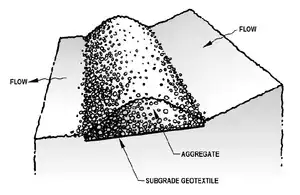

another aspect is water can seldom be "Stopped' BUT can be slowed. One technique on the property is a berm/drain. This is not expensive but takes a little labor enter image description here In a berm the soil is dug and uplifted to create a mini dam to hold the flow thru a gravel matrix to slow its progress.
