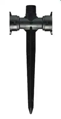

I’ve found the stakes that work with standard 1/2" (13 mm) drip irrigation main, that has 1/2" threaded outlet, on which any regular sprinkler can be attached, either directly or via the riser:
1/2" flow-through stake
And so I could run my drip main along the edge of the lawn, interrupted by few of these stakes. And I could use those small 180° sprinkler heads, such as shrub sprinklers which are the same heads that are used in small pop-up lawn sprinklers for narrow lawns. But my two major concerns are water pressure and flow, and watering time.

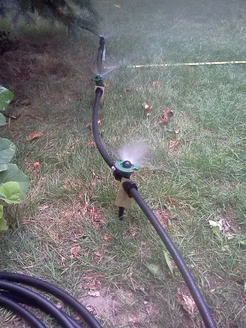

However, I decided to try it out, and see what happens. I’ve purchased the stakes, four spray heads, and short lengths of cut tubing (so that I can return it back to the shop, instead cutting up my own tubing). I had rigged up the following structure via the basic main assembly (back-flow preventer, filter, and pressure regulator), and decent length of the pipe to account for the internal friction losses in real-world application:
To my surprise, all four heads gave solid spray and decent reach with last drops getting to the distance of 3.6 m (12'). Obviously, the effective coverage may be somewhat lower, but still close to the specified maximum range of the spray heads. This looks like viable option for my application, and while I still am considering drip micro-sprinklers, it is nice to know that in that particular case the empirical evidence is more optimistic than basic theory.
