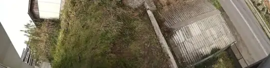

I live in Chile where the land slopes up into the hills just a few meters from the coast. I have a garage at sea level with the back wall in the ground and there's a little river flowing inside it. I am told it's from leaking sewage tanks above and a normal phenomena. It's like a liter of water per hour - it's significant, not just a wet wall.
Knowing that some plants require a significant amount of water and considering behind the garage is just a lawn, would it be possible to remedy the problem with plants? There's around 10 square meters of space and it's pretty sunny. The roots would need to go 2-3 meters down. Are there plants suitable for this? Which plants evaporate most water? Does it even make sense? :-)
Edit: A bad vertical panorama of the location from above: garage and hill slope
It's not ground water, it's leakage from sewage water tanks on the hills above. Or so I'm told, but it can't be ground water, the levels aren't that high here.
EDIT: Late revelation: It actually IS ground water. The slope was artificially created and apparently they dug a bit too deep. I guess it's time for a pond. :-)
