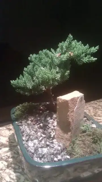

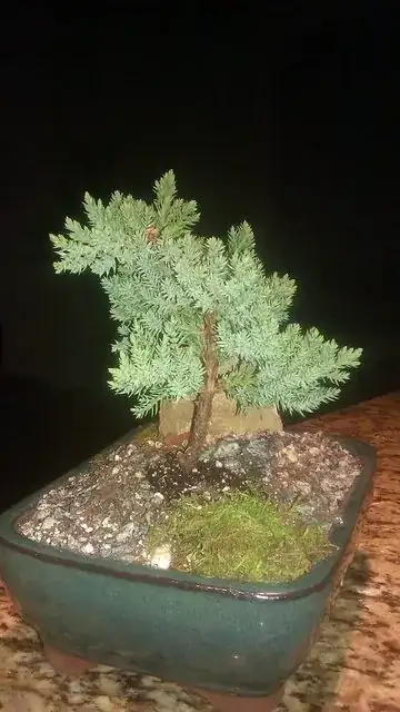

I would like to achieve a Cascade looking shape for my bonsai and would appreciate advice as per how to trim my current tree.
Here are the pictures:

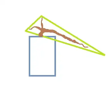

Looking at the image below you can see the pot represented by the blue rectangle and the shape of the tree by the green triangle. This triangle is just representative of one type of cascade, but based upon the tree you have to work on, the three points would shift to suit. However, the idea with cascade style is that the lower most corner is placed below the top of the container and this point being the furthest away from the center.
Also notice that there should be three parts to our triangle in order for the tree to have a triangle shape. This is usually achieved by having two side branches to be the back and top and the main trunk of the tree to produce the cascade. This can also be achieved by using three branches if the main trunk is already too rigid or old by selecting a long branch to cascade and removing the main trunk or significantly shortening it show that new growth coming from the top can be the top of our triangle.
See the image below for an example of the main branch structure underlying the cascade shape.

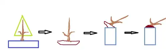

In most cases if you are transforming an existing tree into cascade style or if you just bought a new tree from a nursery you will need to move it into a new vertical pot. At the base of the pot place the crushed tile (or similar material) and fill about 1/5 to 1/4 of the pot. This step is not necessary if your tree is small, the idea is to assist with draining but for small pots the water should easily drain freely.
On top of the crushed tile fill the rest of the pot with a good soil mix (search on the internet for what mix you should use or buy something suitable from a nursery) making sure you leave enough room for the soil attached to the tree.
Remove the tree from its existing pot keeping as much of the existing soil as possible. Because we are already going to disturb the plant by shaping it, it is best not to replace the soil and do significant pruning / wiring / shaping at the same time. You may be able to tease some of the roots out at the base of the root ball depending on the size of the plant.

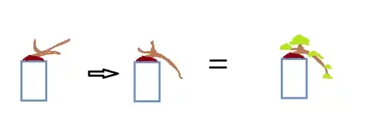

Place the tree on top of the new pot at a suitable angle (refer to the picture below). Firmly press down so the base of the trunk is near level with the top of the pot. The back side of the plant that is now sit on the angled up side of the root ball needs to be push down so that it secures the tree firmly inside the pot (refer to picture below). If you leave some of these roots exposed they will die off if they are not getting enough moisture. If you feel necessary you can cover these roots with extra soil to maintain plant health until more deeper roots have grown. If you have a sufficient number of roots you can trim off some extra roots at the back to get the right aesthetic.
For the picture below the green triangle is only shown in the first part, but this doesn't mean that you need to remove leaves, it is just easier to show branch structure rather than the shape of the tree.
