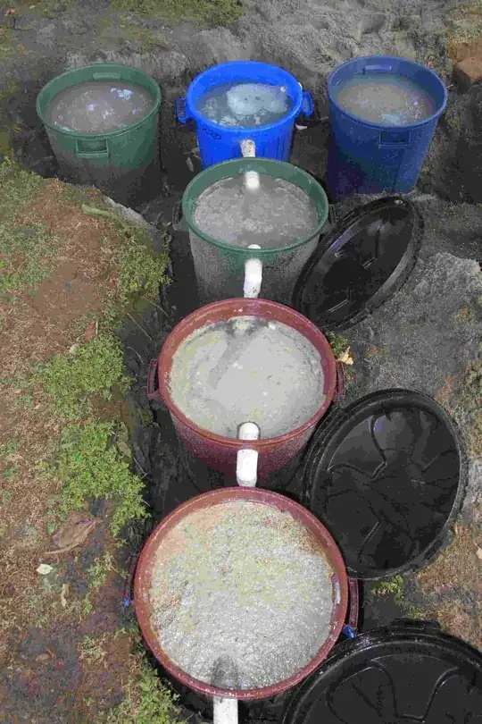

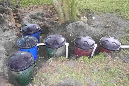

The grey water is coming from the kitchen. The kitchen is aware to limit the amounts of solids and grease/fats to throw in the kitchen sink. The grey water pvc pipe flows downwards to the first 3 plastic tanks (right to left) that act as grease traps. See picture below:
In the first grease trap the oils/grease float to the top and then flows to tank #2 and #3. You can see that there is less and less oil/grease. First tank at the bottom of the picture is where the kitchen grey water enters. The 3 tanks at the top of the picture are the 3 plastic tanks that fill up with water that contains almost no grease/oils. This water will flow to the banana plants. The grease traps function in order to prevent the grease and oils to clog the soil. Note: The grease in the grease traps are removed on a daily basis. See picture below.

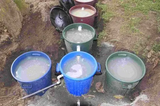

The 3 nutrient filled water tanks without grease look clean a significantly cleaner than the 3 grease traps. These 3 water tanks also equalise and fill up at the same time. At the bottom of the middle blue coloured tank is where the water flows to the banana plants as soon as I open a pvc valve. As a way to prevent overflow in these 3 tanks I have added on top an overflow that runs to some ornamental tubers.

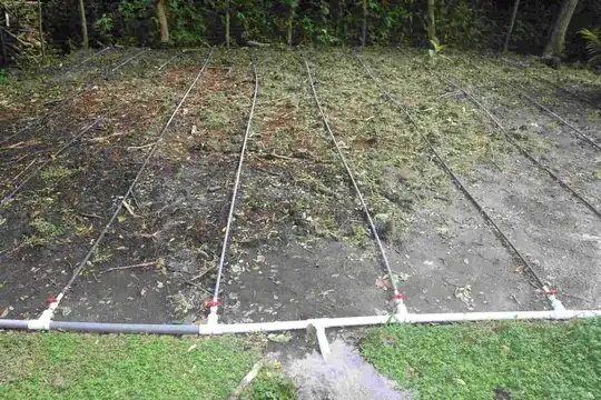

When the tanks are full we open the valves that we need. See picture below:

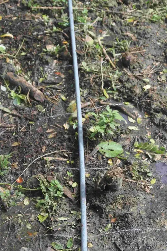

This water flows through perforated 1/2 inch pvc pipes to water the banana/plantain trees.
Note: the banana plants have just been planted but this is not shown on the current pictures. I'll update those with time and growth.

In no order of importance:
  • are small insects or animals going to find inside the pipes to be a nice place to nest or otherwise obstruct?
  • are larger animals or people going to step on/trip/break the pipes?
  • if it is dry for six months of the year wouldn't it be better to store even larger quantities of water? Yet this requires some kind of treatment or the greywater will go off. And conversely, in the wet season will the system be adding even more water into the planting beds than is required?
  • larger scale projects usually have an organic component like a reed bed which does a great job of removing traces of grease and contaminants
This site raises some pertinent issues
  • if you don't use greywater within 24 hours then it can become unusable as bacteria multiply very rapidly in it
  • don't apply untreated greywater onto plants which have fruit or vegetables that are eaten raw. This is a precautionary health and food safety issue.
  • don't apply greywater onto saturated soils as it will runoff. What happens during the rainy season?
