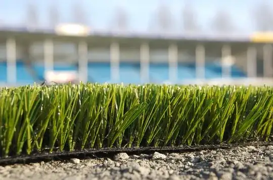

They sell artificial turf at Lowes, Home Depot, and online. Check the carpet section of your local big box store. Then you won't have to worry about getting dirt in the garage, or house. The newer stuff is far more realistic than the old "Brady Bunch" style artificial grass.

I think artificial turf is the best option.

I'd go for the artificial turf option - even if you put six inches of topsoil down, the drainage will be very poor, and any turf laid will start to look very sad indeed within a few months, and particularly after/during winter. I've given a point to Tester's answer because he's right when he says there's been a dramatic improvement in the appearance and quality of artificial turf, so much so that some was even used at the RHS Chelsea flower show this year, and the garden got a silver medal. I certainly had trouble distinguishing it from turf without very close inspection. Using this product will also solve the problem of dirt getting into/around the garage, but you will need to be careful about dropping hot things on it (like barbecue coals) and, as with real turf, will also need to clean it up regularly if your dog uses it as a toilet.
