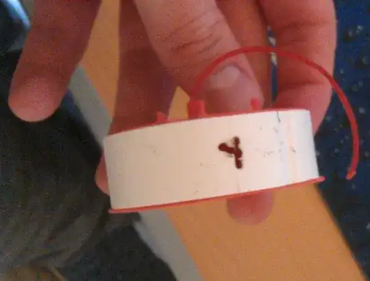

I have tried taking the mechanism apart, and the housing for the fibre line has this notch in it: enter image description here

But every time I try to use the strimmer, the thread seems to break inside the spool; there is no thread coming out of the hole, so it looks like it is being cut at that notch in the white housing (weird, because it's not sharp; I tried pulling the thread against it hard and it didn't break).
The insturction manual obviously shows this as a horizontal slit so the vertical slit that is there, could that be something that has developed over time with use? And could that be what is causing the thread to snap internally each time I use the strimmer (it happens almost immediately when I try to cut some grass)?

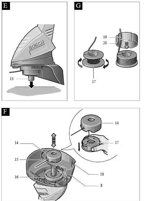

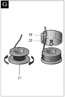

If you consult the manual, you find that the part the line comes out of comes apart to expose a bobbin inside of the housing.
You need to find out what the recommended diameter of the line is for the trimmer and get a spool of replacement line.
Hand rewind the bobbin in the proper direction, usually they have an arrow on them to tell you this. Poke the tail out of the hole in the housing when you insert the bobbin, allow about six inches, clip the lid back in place, fasten per manual directions and proceed to use.

A lot of people recommend soaking the trimmer line in water for a couple of days so that it's more pliable and breaks less. I've even seen it recommended from manufacturers of trimmer and trimmer line. Some lawn professionals I've seen buy a big spool of line and keep it in a 5 gallon bucket of water all the time. Nylon is hygroscopic and does absorb water. Try soaking the line for a couple of days to see if it breaks less.
From what I've seen of your trimmer you buy replacement cartridges with spool and line already wound on it rather than buying separate line and winding the spool. You may be able to buy the same thickness of line in bulk and rewind the spools yourself to save some money.
