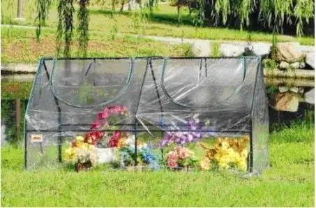

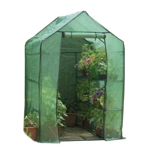

You are not likely to find a clear PVC cover (as in the OP second photo) that will survive sunlight for more than one season. The green one (as in the OP first photo) looks like a polyethylene mesh which is often treated to resist UV radiation, which means you should get two or more years out of it.
If treated, the green one will last at least twice as long as the other which should be a major purchasing consideration.

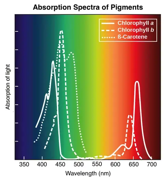

Caveat: This answer assumes that the green plastic shown is pigmented green and thus transmits green light into the greenhouse. Certain metal coatings could reflect green light but transmit blue and red wavelengths (which would provide plants with an optimal environment but be rather expensive to engineer). To understand the illogic of green pigmented plastic, take a look at the absorption efficiency of plant pigments enter image description here. The solid line, Clorophyll a, is the most important pigment for most of the terrestrial plants. The two peaks around 430 and 660 nm mean plants most efficiently convert blue and red light into energy for growth and respiration. PAR (photosynthetically active radiation) light meters are calibrated to measure blue and red light. Unfortunately, green-pigmented plastic is green because it absorbs about 50% of the PAR radiation. Green greenhouses may sell because they look nice, and still transmit about half of the PAR radiation, but a 50% shade cloth would produce far more cooling inside the greenhouse without reducing PAR one bit more. I've got a friend who just bought a green plastic greenhouse, and I am going to offer to help him replace it with a proper 6-mil UVA shielded greenhouse film. And see if we can get his tomatoes and peppers growing properly.
