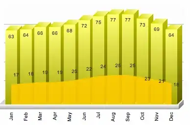

Here are the average temperatures on the island:
