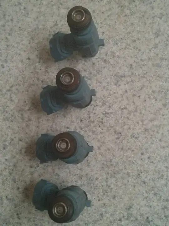

I have a total of 4 fuel injectors in my hand, and was wondering how I'd go about cleaning them, and how to tell if they're any good. I do get a loss of mileage, and my engine hesitates a lot. And i did receive a p0171 code. So i thought i'd check the injectors first.
But do you guys know any good ways to clean this? It's ridiculous to go in to a professional and pay all that money when i have them in my hands.
these are all four, but the very top one has a crack around the ring, would that classify as a bad injector that needs replacing?
all of my O-rings look perfect, so I don't think that's an issue.

The injectors you have shown in your pictures are not servicable items. They can be tested using the appropriate service machinery. You should be able to get a new set of external seals though. When tested professionally they are tested for their electrical performance, delivery performance, and spray pattern over varying fuel pressures and voltages. Anything other than a professional test is a waste of time and inconclusive. There is also a safety concern when they are interfered with in an amateur way. Modern vehicles are a lot more complex than ever before, especially because of the all-embracing electronics used today. Service centres and garages have to make a large investment in their equipment and this has to be charged back out. If the cost of testing is too great for you to afford then you are left with the only option of buying new replacement injectors. In the tank fuel additives never live up to the blurb on the can, and can even make matters worse by releasing contaminates to go around the fuel system.

You have a couple of choices here, neither of which includes you cleaning these yourself. You do not have the equipment or chemicals to correctly or efficiently clean and flow test these injectors. It is important to ensure each of the injectors flows the same amount of fuel in a given time at a specified fuel pressure. Only a professional service can provide this for you. You cannot just spray your injectors with carb cleaner and expect them to be clean and work correctly.
This leaves you one of two options:
First, you can replace your injectors with new ones, or for a better price (approximately half), you can purchase rebuilt ones.
Secondly, you can have yours sent out for rebuild. In doing so, the rebuilders will clean yours (probably with an ultrasonic cleaning machine, something like what is used to clean jewelry, but with chemicals to clean the injectors correctly and safely), replace any worn parts, check the electrics (solenoids, connections), and flow test them to ensure each is flowing the correct amount and the spray patterns look good. This process is a little cheaper than buying rebuilt ones, but you have the time factor involved in shipping and down time of your vehicle.
You made mention of your o-rings looking good. If these are the original o-rings, I can almost guarantee you they need to be replaced. While there might not be any visual damage to the o-rings, they do harden over time and conform to the hole which they have been stuck in for all those many miles. If they are left alone, they will provide many, many miles of worthy service. Once they are dislodged from their holes, trying to put them back is not only difficult, it will almost assuredly allow for leakage of air past them, exacerbating your lean condition. New o-rings are cheap. If the o-rings are original, they need replaced. Ensure you put fresh oil opinion them to help in insertion and to help guard against damage during installation.
