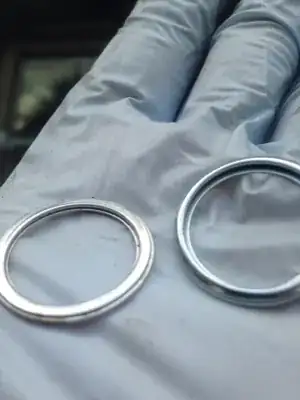

I just did an oil change, so here's a picture of the washers (used on the left, new on the right):
Used and new washers
Notice that the left one is appreciably flattened.
My understanding of the crush washer on your drain plug is that it's not a gasket -- i.e., not to keep fluid from leaking out -- but serves as a lock for the plug, and also as a mating surface between the steel of the pan and the steel of the plug, so that neither damages the other. Given that, and given that it deforms in order to fulfill its locking purpose, I believe it's best to replace it, and I'd suggest using the Subaru washer.
