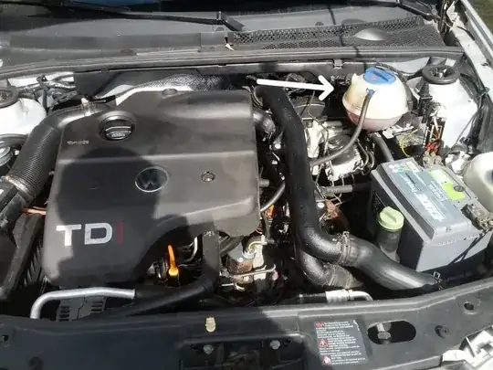

EDIT: Here are some photos;

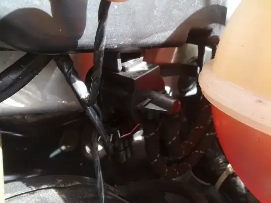

Closeup view. You can see the two vacuum lines, the further one is not connected to anything.
General position. It is clipped to the bottom of the cable and vacuum line tray, just behind the coolant expansion tank.
EDIT 2: When I said "It isn't connected to anything on the actuator side", I mean literally that: there is a vacuum line coming out, but it isn't connected to anything. And I cannot see an obvious connection for it.

I found out what it is. It controls the air recirculation flap to the cabin. Nothing to do with the engine at all.
Just above the input and output pipes to the heater core on the firewall is a little plastic nozzle. This is what this actuator is supposed to be connected to.
