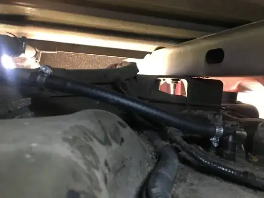

There is a MUCH easier way to resolve this issue.
I know this post is older, but admins, please advise future repairs to give this much easier method a try.
Drop the exhaust on the truck/van, and access to the top of the fuel tank is a breeze. It took me about an hour, and I’m no mechanic, to replace my fuel evap hose on my 2006 Ford F-150. Once the exhaust is out of the way, you can literally reach anything you want that connects to the top of the tank.
I only took one picture because I wasn’t going to post about it, but decided I would try to save someone the money and frustration. My repair cost $5, and 1 hour of my time. I completed it by myself.
I made a small video, but can’t upload it here.
