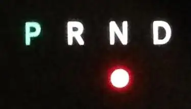

I've noticed there is a red circle showing up underneath my "N" on the dash.
Dot is not flashing and has remained on for last couple of days.
Can't figure out what it is from Google/manual. Any ideas?
Thanks
Thanks
I found a copy of the owner's manual here. Pages 284-285 have a diagram of the instrument cluster, where this light appears as #17. Page 294 says that this is the Vehicle Security Light and explains:
This light will flash at a fast rate for approximately 15 seconds, when the vehicle security alarm is arming, and then will flash slowly until the vehicle is disarmed.
