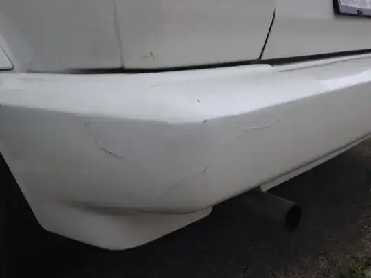

I sanded and filled a dent in my cars plastic/foam bumper, applied primer and factory matched auto paint. This worked and look fine for about 6 months. Today I noticed the paint around where the filler is is beginning to crack and peel.
Would anyone know what could be causing this or what I did wrong?

You need to use a flexible body filler specifically intended for polyurethane bumpers. It looks like the filler you used has detached from the substrate due to flexing (which could be solely due to temperature and not impact). The filler you used was for small dent repair on non-flexible metal panels.
Also, I don't know how big of an area you filled but the painted area is larger than the area that a "small dent" would cover. Damage of that size and on that material requires special fillers.
