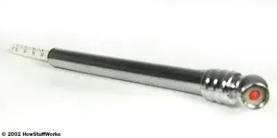

As a sanity check, I'd recommend buying a cheap, simple, mechanical tire pressure gauge to verify the values. Regardless of brand, the gauge should be dependable and tell you what is really going on.
Tire pressure gauge

I also suggest getting a second gauge, but would caution that the pop-out stick type pictured above are notoriously inaccurate and would suggest a mechanical dial gauge as the best type to buy. With the price of tires, this is well worth a second opinion!
