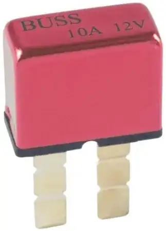

I'm always rewiring something or upgrading a component here or there on my vehicle. I recently discovered self-resetting breakers that can replace standard automotive fuses.
This seems like a silver bullet to never having to buy fuses again, but I'm concerned there may be some tradeoffs I'm not aware of. Are there? Could heat be an issue if the entire fuse panel was filled with these?

A fuse blowing indicates something is wrong. This could of course be a transient that just requires a fuse replacement or a trip reset, but what if it's something more serious, like a short allowing high current to flow through sensitive components, or to ignite something flammable? Or an indication of failure of an expensive part.
A self resetting trip removes the human from the chain, so how will you know what is wrong, or potentially even that something is wrong.
Please don't do it - it's a massive safety issue.
