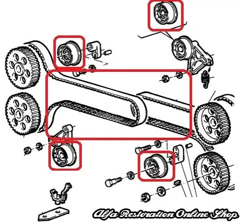

Surely, to get a Subaru (or any true boxer engine) to run in this kind of configuration is relatively easy. Bear in mind that you are talking about an engine with two horizontally opposed cylinder heads and a four stroke so for each revolution of the camshaft, there are two revolutions of the crankshaft. Each piston hits it's "top" of it's travel twice, once after it's compression stroke and once after it's exhaust stroke.
In usual four stroke applications, one piston will be on it's compression stoke, one on it's combustion stroke, one on it's exhaust stroke and one on it's inlet stroke. Cam timing events are set so that the exhaust valve is open during the exhaust stroke and the inlet valve is open on the inlet stroke. During combustion and compression, they're both closed. With me so far?
Now, look at an engine like the Alfa Romeo boxer engine and you'll notice that it has two timing belts.Alfa Boxer 16V timing exploded diagram
Imagine what would happen if the timing belt was fitted incorrectly such that the timing marks on just one bank of the engine (cam wheels) were 180 degrees away from where they should be. The effect would be that bank one and bank two would now be on their compression or whatever strokes at the self same time. Of course there is the slight issue that the spark plug would now be firing 180 degrees out of step with bank two. However, imagine you could connect the spark plugs from cylinder three to that of cylinder two and that of cylinder four to cylinder one. You'd now have two cylinders on firing their plugs at the same time. If you had a carburettor engine, you can stop now as you've achieved your goal.
For fuel injected engines, you'd have to tie the firing of the injector up across the two cylinder banks too. However, this wouldn't be a massive undertaking either as all you would need to do is tie the bank that's 180 degrees out to the injector event of the bank that is timed correctly. All of a sudden, you've got an engine that behaves as your described.
Real world implementation would mean either willfully fitting the timing belt 180 degrees out or removing the keyway from the camshaft (or using a modified set of pulleys) so that the cam was 180 degrees out compared to the cam wheel. On a fuel injected car you could reprogram the ECU to move the bank two injection and ignition events to be the same as bank one or you could physically disconnect the wiring from the fuel injectors and coil pack from the bank two loom and bridge them to the bank one connectors (I'd rather do this in the ECU software and bridging the connectors would be a bit of a "hack" but no reason why it wouldn't work provided the harness and any relays you used were up to the job).
For boxer applications, I think that is pretty much all and everything you'd have to do.
