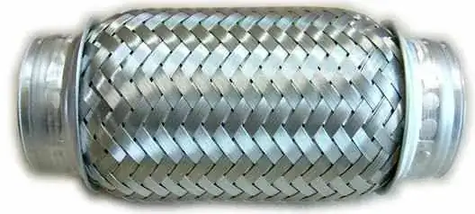

I don't know if that's the case on an S80, but many cars have a "flexible hose" kind of construct between the exhaust manifold and the exhaust pipe which can leak without visible holes. enter image description here
To ascertain where the leak is, look under the hood, around the front wheels and under the car when running. Try plugging the rear end of the exhaust and see if a pressure is built up, if the exhaust system is okay it should.
